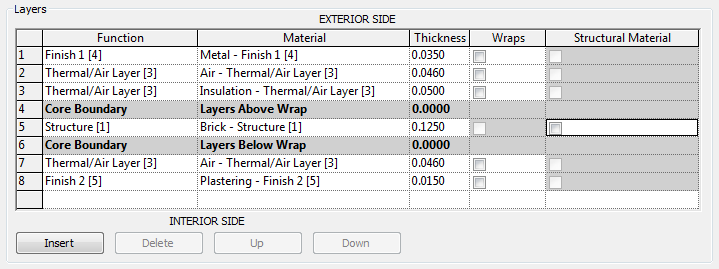

What is the actual role of Thermal/Air Layer? More than just a priority layer?
Hi Revit users,
Just a quick question.
Does the Thermal/Air Layer [3] do anything more than one of the priority layers?
For instance, it could be used for MEP analysis or something?
I am trying to figure out effective set up for compound walls.
To join the walls and the layers ideally, I might want to ignore the name of function sometimes.
As Revit has is a such a well-organized system, I am afraid it might have more value than just
one of the prepared and named layers.
If you know about this, please share your knowledge with me.
Thanks in advance.
Yuki

I researched this topic before. The role of the layer does not affect the analysis. Just the properties of materials and the thickness of the layer affect.

Hi @ysautodesklover
According to the article Thermal/Air Layer [3]: Provides insulation and prevents air penetration.
See image below:
Hope that helps!
