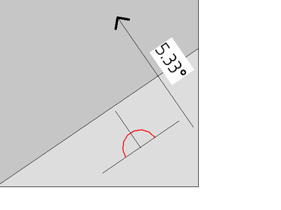

Here is with checked: I got a family hosted on a sloping floor
and here is with Draw in Foreground unchecked: the part that previously got cut away by the sloped floor is now visible.
Please note that, for this to work, I had to place the red lines on another reference plane than the level plane, plus I had to raise it above the level-level so that it wouldn't get buried under the sloping floor.
For reference; Here is an example where the slope is extremely steep, and as you see the red circle got buried.
To sum it up: Draw in Foreground for Symbolic Lines, what does it do?

I treat Foreground as hybrid 2D symbolic/model lines and Background as hybrid symbolic/annotation lines.  They could have used some better wording instead of Foreground and Background though.
Nachricht 5 von 7
Haider_of_Sweden
als Antwort auf: ToanDN
Aha.. So if I understand you correctly, no matter the linetype (symbolic or model), if I have Foreground checked either linetype behaves like model lines, ie hidden if physically hidden, and if Foreground is unchecked either linetype behave like symbolic/annotation lines and hence visible?
If yes to above, then at least the wording should be the other way around, no?
(edit: corrected Background to Foreground)
