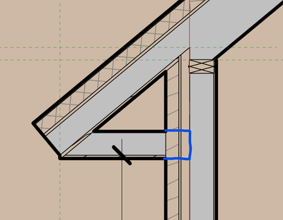

I want to be able to have the exterior siding lower than the top of the wall, which I can achieve with Parts, and also be able to join the wall to other walls and roofs. Can't do both.

How about this way?
Nachricht 7 von 24
als Antwort auf: mpukas
Attach the wall twice, first to the roof, then to the soffit.

@ToanDN I don't understand how you did that. When I Part a wall, and Join it to other element(s), I get this Error:
Revit will not allow me to have a wall joined to other elements, AND the wall to be Parts and one of the those Parts adjusted with a Shape Handle.
Nachricht 9 von 24
I showed that you don't need to convert walls to parts for what you are trying to achieve.
And you cannot join parts with other components, only merge parts with parts.

OK, now I see that you've used one wall. But, I still do not understand how you got the exterior finish layer to not go above the soffit. This is what I get: all layers of the wall go the full height of the wall, and the exterior finish layer goes above the soffit.
Nachricht 16 von 24
Extend the boundary of the soffit to the core of the wall.

I'm using two walls, the stud wall is on the right side of the Grid, the insulation and finish is on the left side of the Grid. But that's irrelevant for this issue. Soffit unjoined:
