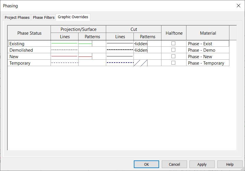

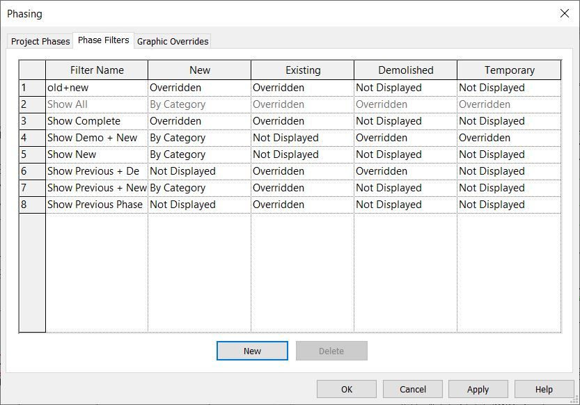

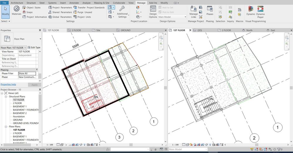

When i turn on the phase filter for the new and existing constructions as overrides, the wall become solid fills and this is not what  i want them to look like, is there a mistake in the filter i madephase filter 2.JPGphase filter 3.JPGphase filter.JPG

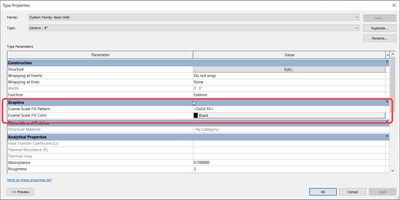

The Solid Fill is coming from the Wall's Coarse Fill ?
Also, your left View Phase Filter is set to "Show All"  What's the right View Phase Filter set to?
This video may help your understanding. It's a good place to start at least.

thanks for your suppor , you've been a major help in my problems . I appreciate it a lot. But for this problem , the solid lines were removed by changin the stuctural material from brick to air, eventhough i had no idea as to why the brick was shown as solid when there were none in the graphical settings. thanks a lot for the help
