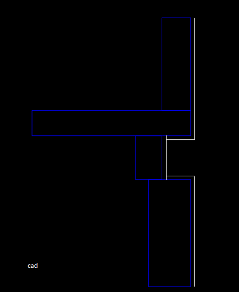

As per the attached 3d section, it shows that the finishing material is not wrapped properly, the layers are not wrapped like it's shown in the other picture snapped from autocad. i drew the method which i need to reach in the autocad.
i also attached the revit file
please helpice_screenshot_20170301-093957.pngice_screenshot_20170301-093936.pngice_screenshot_20170301-100253.png

Are we looking at a section or a plan?

section

  1. did u check the box for warp at inserts?
  2. the insert you have there; is it an in-place void, a wall sweep or a family? (Behavior differs)
Note: even if wrapping is enabled; it does not apply to:in sections...the Layers at the top(header) and bottom (sill) will not wrap the same as u see in plan view

OK , here is the rvt file, please tell me how can i reach the same as the cad sketch..

You could create parts from the wall layers, split them, turn on shape handle and stretch to the size you need, then change the material to match the finish.  It is quite time consuming and you need to be familiar and comfortable with editing parts.
If it was me, I just paint the surfaces to match the finish materials, and add 2D detail components to the section and detail.

Although i cannot consider this is a solution, but thanks very much for the idea and the respond
