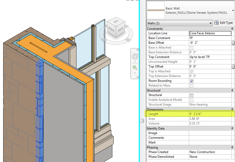

Is it possible to get finish layers of differing thickness and finish to wrap at core aligning walls?  I have tried this solution (http://forums.augi.com/showthread.php?134582-Can-t-get-brick-to-wrap-wall-join) but it didn’t work.  I have experimented with wraps and wrap joins, but cannot get the intended result.
See below for explanation.
3D image for intent clarification
Wall properties are below
Thanks much!

Not sure if you have already done so, but try clicking "wrapping at ends" and set to Exterior ( or both?).

I have tried.  It doesn’t work.  It will wrap at the unattached end, but not at the join between the two aligned walls.

I think you're speaking to one of my biggest frustrations. I just resolve it by just placing a very short perpendicular wall composed of the layers I need to "wrap".   It's always a pain in the butt.

This is as close of a solution as I can get.

@ennujozlagam I tried the proposed solution, before and after your post.  I just wind up with a hot mess. :verwirrtes_Gesicht:  The structure wall layer of the short wall wants to push all the way through to the finishes on both sides.
