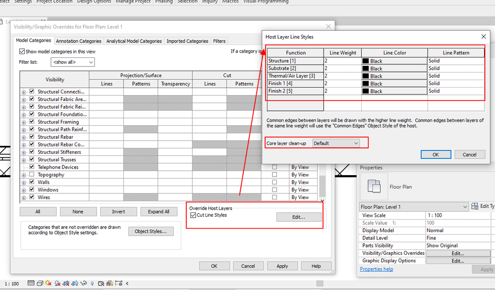

Can anybody help me out how to show correct lineweights in a floorplan/section?
Problem: different layers of the wall (thermal/structure/finish) do NOT show the correct line thickness.
-insulation should be pen 3
-finish should be pen 4
-structure should be pen 5
In the attached picture the thermal layer is drawn as pen 5 and not pen 3.
What is going wrong and if so is this a malfunction of Revit basic wall functionality?Knipsel.JPG

should I understand that the VGO settings  from Override Host Layers>Cut Line Styles do not work for you?

What i just discovered:
-VGO for model categories: apropriate wall subcategorie i set the cut linestyle to the smallest lineweight in the basic wall (pen 3)
-Override host layer is active (core layer cleanup is at default)
Now i see the correct linetypes being displayed but it only works with a combination of view template-vgo override for walls and override host layer active.
Thanks for thinking with me!
