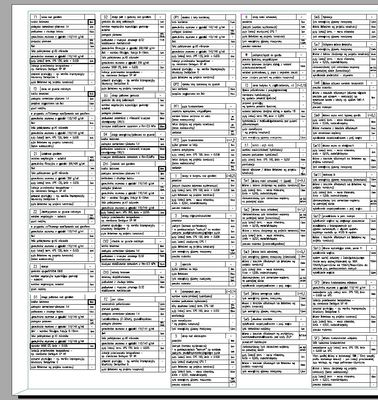

I literally want to copy this list of layers to sheets:
After years of using AutoCAD, I'm trying to perform my basic tasks in Revit, and my first problem is the list of layers in all the walls in the project. In this case, the order on the list is important. Since I can't tag membranes, I can't replace my lists with images/sections. Duplicating layers due to required fire resistance has already cluttered the project. I haven't gotten to Dynamo scripts yet, but they would also work semi-automatically. Keynotes seems to work the same.

Luckily, I found a solution that uses a modified file provided by "ROCKS engineering".
Here's the link to the video: https://www.youtube.com/watch?v=KgaYlyIVnxo
I added a new project parameter for walls called "multi-line text."
Their file lists all of the existing layers in a wall, in order, and includes chosen parameters (here thickness).
I inserted this data into my new parameter.
I drew the walls that I'm interested in on a new Phase.
I created a filter in Regular Schedule by Phase.
I inserted the filter into a sheet.
List includes duplicates and membranes.
