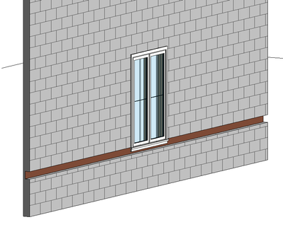

I have a window just sitting on half of the wall reveal. It disconnected between the window, but I want it to go through it with half of it being covered by the window. How to solve this? Thanks!

Place it Below Window then Align or nudge up

I do not know why I cannot repeat your solution, when I use move/align/nudging by arrows, the reveal will split once it touches the window.

Flip it down using the flip arrows ... end grips should be at the bottom. If they are at the top it will split once it intersects the inserts
