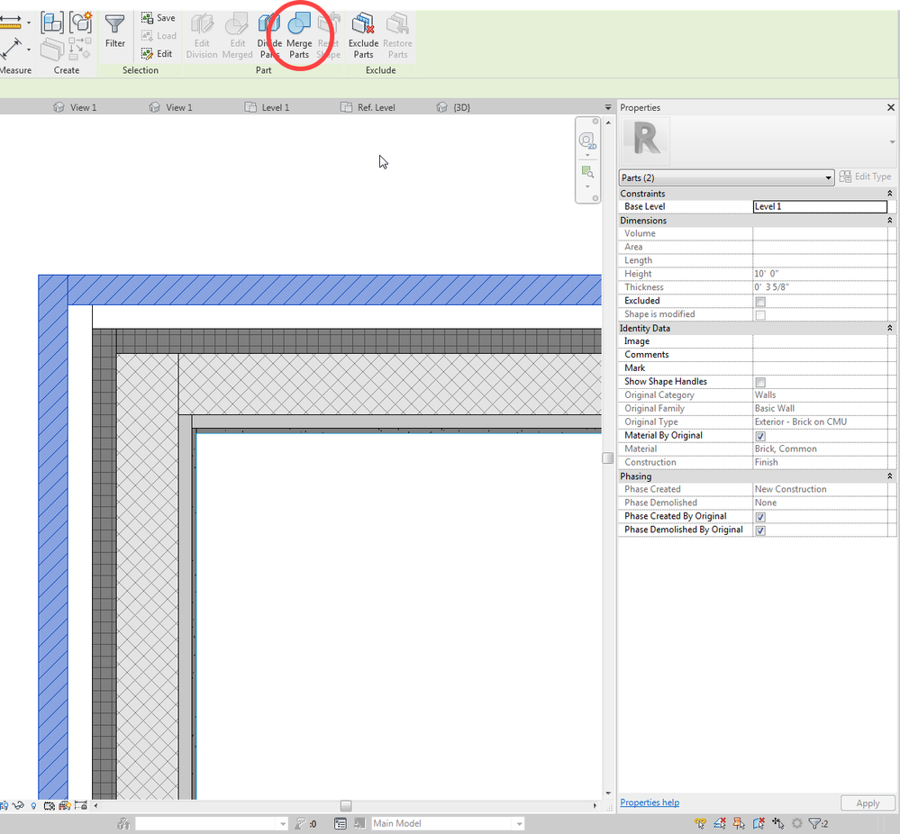

Hi all,
I am trying to prepare a wall family and divide it in parts in order to show core for structural drawings, and core+finish for the architectural one.
If I show parts instead of show original, the connection between parts is unclear.
How could i solve the issue?
1 ANTWORT 1
Nachricht 2 von 2
als Antwort auf: XXalessio.amodioXX
Merge parts.
