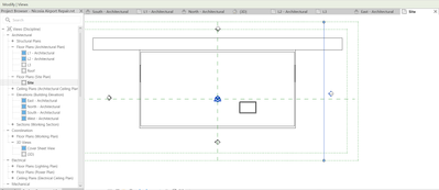

Hi guys, I'm using wall division to create panel patterns, it does show up in 3D view, but not in elevation views... screenshots are attached. Really appreciate any insights or help!

It seems to me that you have done this design using Parts. In the elevation view where you don't see your design, most likely the visibility of parts is disabled. In the properties of the view, find Parts Visibility and select Show Parts.

Thank you Alfredo! It works, but also another problem came. So I excluded some parts, but it still shows up in the elevation view. I have attached the screenshot here.

You can select Excluded parts in any parts view but they are not actually visible.  What you see there is the element behind the excluded parts with the same material.

thank you for your reply ToanDN! yeah, I noticed that the excluded parts could be still selected. but there's no solid component behind this, so it should be clear glass and interior, but currently I could see them.

Select the excluded part and temporary hide it, then select the element behind and see what it is.  You can share your model here if you want.
