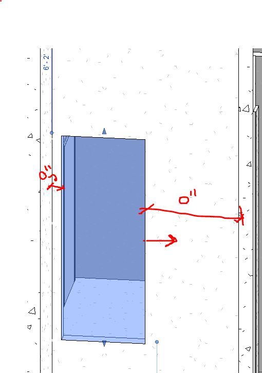

I have a wall opening that I would like to stretch out to be across the entire width of the wall it is cut into. When I select the opening however, I don’t get any horizontal control handles or dimensions in plan, and only vertical dimensions when it is selected in 3D. I also tried creating ref planes and align the edges of the opening to the ref planes, but it won’t do it. Any clues what I am doing wrong?

Is it a family or created from the Wall Opening tool?

PhilvK
I created it from the wall opening tool.

Try selecting the wall which the opening is cutting through and "disallow join" at the ends of the wall opening.

I had a similar issue and the culprit was a perpendicular wall above the opening. The opening was acting like a wall in the sense that it was essentially joining the wall above as if at a corner. Once I disallowed the join of the wall above I was able to move the shape handle far enough away from its original position that when I allowed the wall join the opening did not try to connect to it again. I know this is an old post but thought it would help if others are having problems currently. By the way, I am using Revit LT 2017.2.3.

Try activating controls and dimensions. I was having a problem with this, too. I was able to precisely adjust the dimensions for other wall openings, but I can't understand why a new wall opening did not have the same controls. Fortuna, I checked the ribbon and saw the button for activating controls and dimensions.
