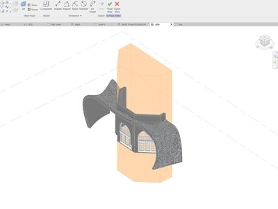

Hi
I would like to remove the interior part of Wall Mass and I can't find a way.

This?
Nachricht 3 von 12
zs-17
als Antwort auf: barthbradley
Yes. How to do it?

Just edit your lovely in-place mass and add a void mass to cut the solid mass. Then finish and close out of in-place mass edit mode, select your wall by mass face and press "update to face" on the contextual tab.  Bada bing.

I did this and get these messages
Nachricht 11 von 12
als Antwort auf: zs-17
I suspect the Void Form is not intersecting the Solid Form.
Nachricht 12 von 12
zs-17
There is an intersection.
