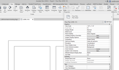

Hello!
I am working in a template file. Revit 2020.
All walls do not clean when joined. Comparing this to active projects and mucking with the view's and wall's properties. They work in the active projects - issue just seen in this template file.
No view template is set. Looks like the View's instance properties are correct for the Wall Join Display - but curious I have not been able to activate. Nor does it seem to clean the wall joins... Anyone seen this?

Project view when template is used:

Are you working with Parts?
Yep, I just noticed it. Set Parts Visibility to Original.

It was a check box in the lower right hand corner of the V/G Overides Model : Cut Line Styles.
UNchecking fixed it.

You mean it isn't linework from Parts?
Nachricht 6 von 7
sara
als Antwort auf: barthbradley
Yes - No parts.
Revising the Both to Show Original did not change the wall join display I was seeing.

Just wandering for same thing, recently discovered that Wall join display parameter is only enabled in coarse detail level. I leave here in case it still needed...
