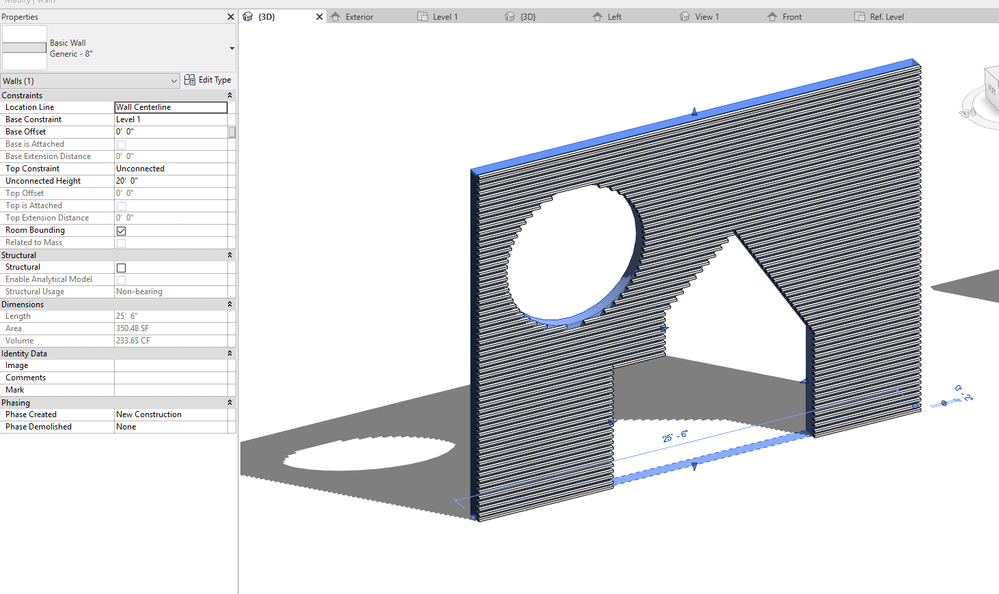

You can control the size and spacing of the louver.  The one I show you are all mullions, no panels (see image 1).
But you need to match the opening and overall dimension of the curtain walls to the normal walls and openings, which is not terribly difficult to do.  In fact you can copy the wall to an offset distance and change the type to the louver curtain wall type (see image 2).

Very helpful. Thanks! Didn't know you could swap the wall out.
