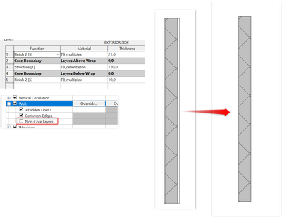

You can change your wall type and move the finish materials outside the core and then use the VG settings (see printscreen). Another way is to model each wall separately and use filters, for example.
