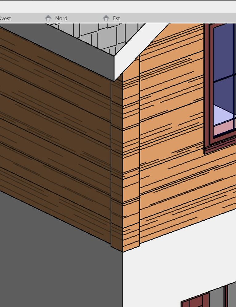

Hello, someone can say me how can I pot this wall frame at angle of the walls and the frame between stone wall and plaster?
For the first have to put an architectual column sizer than wall?
.rvt file attached.
Thank's

I did an in place family extrusion, but i am not sure if this is what you were looking for :leicht_lächelndes_Gesicht:
I'm sorry if i misunderstood your request. Please let me know if I did :leicht_lächelndes_Gesicht:

I put architecture column and seems ok but don't know if is the right way to draw.
After I put a vertical pat to seem the same texture (fisrt and second pic).
I ask also an other question: the frame between stone and white wall (pic 3).
updated .rvt file attached.

Did I understand correctly that you want the pattern rotated on the architectural column?
Because you can to rotate a model pattern on a column, however you would have to do that within the column family. And if it's not there already transfer the material to your column family...

I have used hatchkit to rotate a duplicate of the pattern.
Let me know if it works in the attatched file
Hatchkit is free to download from the autodesk appstore, and allows you to rotate fill patterns very easily :leicht_lächelndes_Gesicht:

"Because you can to rotate a model pattern on a column, however you would have to do that within the column family. And if it's not there already transfer the material to your column family..."
If I undrestand I have to go in family and edit. But the material is not editable.

When you choose fill pattern for a material, you can duplicate the fill pattern. name the new duplicated shingle pattern the desired name. after you have duplicated the pattern that needs to be rotated, open hatchkit and it should show in the browser, and from there you can rotate the pattern. then you should have two shingle patterns, one horisontal, and one vertical.
What i did was make an in place family as an extrusion (it was just a quick way to manually draw a corner profile inside the project
hope it makes sense:)

@AnonymousFYI The material was not editable there directly because it is controlled through a parameter in the family. If you click the small box (right there next to your red line box in your image) you can select which parameter this is or set this to none. You don't want to change it though. You just have to edit the material parameter in the "Family types". You can find it under create -> under properties -> family types (it is the symbol with the four boxes). Your material will be under Materials and Finishes. That said... creating a rotated pattern might be easier for you in this case. Is it joined geometry?
