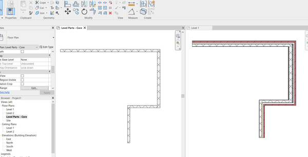

1. I believe u haven't taken a look at the parts schedule I posted in the earlier reply...you can take off volume area length width and height of any material in a single compound wall without creating multiple types. Look at it again those quantities are taken off from the  layers of 1 type compound wall!!!
2. Moreover, I am not sure who the source of your information is...but you can definitely turn off wall layers using filters...image below is a set of different walls converted to parts and a filter is applied to exclude all except the Blockwork!!! Yes you can do shopdrawing layouts for each layer of the wall assembly not just the finish!!!
3. What will increase type of walls!!! I am telling u to use 1 type and you + the other 2 participants whant to use 3 type to substitute 1 meaning as per your solution...on a project which has 30 walls type you will get (give or take assuming some have common finishes) 50-60  types
4. Again … you can control from which level each layer starts!!! you do not need to have 3 types of walls joined in order to control the block to start from slab and plaster from screed!!! and you can do that in a multitude of ways easiest of which is to properly define the structural levels of the compound wall and compound floor so that finish joins to finish substrate to substrate and core to core...I don't believe I need to elaborate on other methodes!!

On small project like yours: say total of 50 walls in the whole project
  • As per your analogy you would be using 5 types but placing 150 instances in the model (assuming each requires 3 walls only).
  • As per what I was suggesting you will end up with 12 types and 50 instances in the model.
Now imagine you are doing that on a 300 rooms 5 stars hotel project or a 1000 beds hospital!!! How will you manage when you end up with 20000 wall instances!!! Seriously...I am not sure how you and who ever is proposing such a workflow cannot see how tedious  using 1 type per wall material is.
BUT Please do whatever you believe suits you best...No one here is trying to convince you or others to take my recommendation. It is only my personal opinion; making 1 wall type for each type of material used in the wall is simply a 2D modeling mindset. Instead of using Revit and imitating AutoCAD's workflow, dump AutoCAD and make use of the functions and parametric interoperability Revit offers. ..I just hope you wont be asking in the future:
