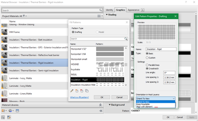

Good morning all.  I have created two drafting pattern - filled regions that work perfectly for rigid insulation.  I would like to add that pattern inside a wall to have it show when the wall is cut.  It seems to rotate the pattern incorrectly applying either of the filled regions.  Is there a setting to "not rotate" or something to get my cut pattern to show up properly inside the wall?
You can see the two filled regions I have created.  One vertical and one horizontal.  If I add either of those patterns to the cut pattern of the wall it shows as the "wall cut pattern" image on the left.   I would like the one on the left to look like the one on the right.  Is there a way to have the pattern rotate with the wall??  Thanks.

Edit the pattern type and switch it from orient to view --> align with element

Sorry, I edited my response. You can do it by changing the pattern to orient to view. I just almost never use that so completely forgot for a second.

Awesome.  I changed it to "align with element" and it worked.  I remembered that variable but couldn't remember whether it either works or where it was located.  Thank you.
