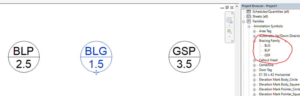

Hi Guys,
Is it possible to create this kind of TAG? The thing is, I have to change the brace element and his length manually
Any tip?

I would create a Generic Annotation symbol family with 2 labels as you show them.  The top label can be a Type parameter, the bottom label is for you to manually enter the value when place it in project views.  If you need a schedule, use Note block and select the symbol family.

Something like this? I have no idea how to load it into my project...
Nachricht 11 von 14
als Antwort auf: Anonymous
I actually did something wrong, because if I change something in the "Bracing Family" it will change in all the other around the project.
I really dont know how to use this XD
Nachricht 12 von 14
Bracing Length should be an instance parameter, not type.
And create different types per your table.  Each type shall have an unique Bracing type, but the Bracing Length varies.

Amazing!!!
Thank you so much.
One more question, how can I load annotation symbols? Right now I'm opening the family and clicking in "Load into Project"
Nachricht 14 von 14
Open the folder and drag the family onto you project view. Or, go to Insert menu, Load family, and browse to the family location. Or, do what you did.
