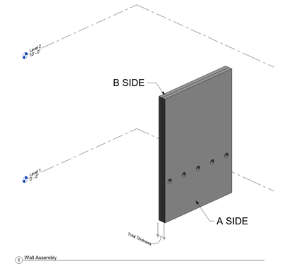

This is how I imagine it would be constructed in the real world...
Nachricht 14 von 23
als Antwort auf: MVE1112
so, in Revit, the larger void would be recessed into the SURFACE of the two walls. Then when the two walls are joined, that larger void cavity would be at the center of the entire assembly.  Get it?
To able to cut both walls in Revit with the same Void Family, you would need to check "Cuts with Void when Loaded" in the Void Family, and then use Cut Geometry tool in the Project to cut both Walls with the Void Family.
