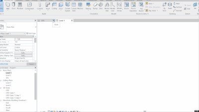

How can I make wall around another wall, or make it cut through it?

Start Wall >> Use rectangle from the sketching tools >> place the outer skin >>> Use line >>> Place wall in the middel
OR
if it is a single wall with multiple layers...you can use a void to cut it (In place component or Family)

Combined shaft cutting with void cutting, that works.
