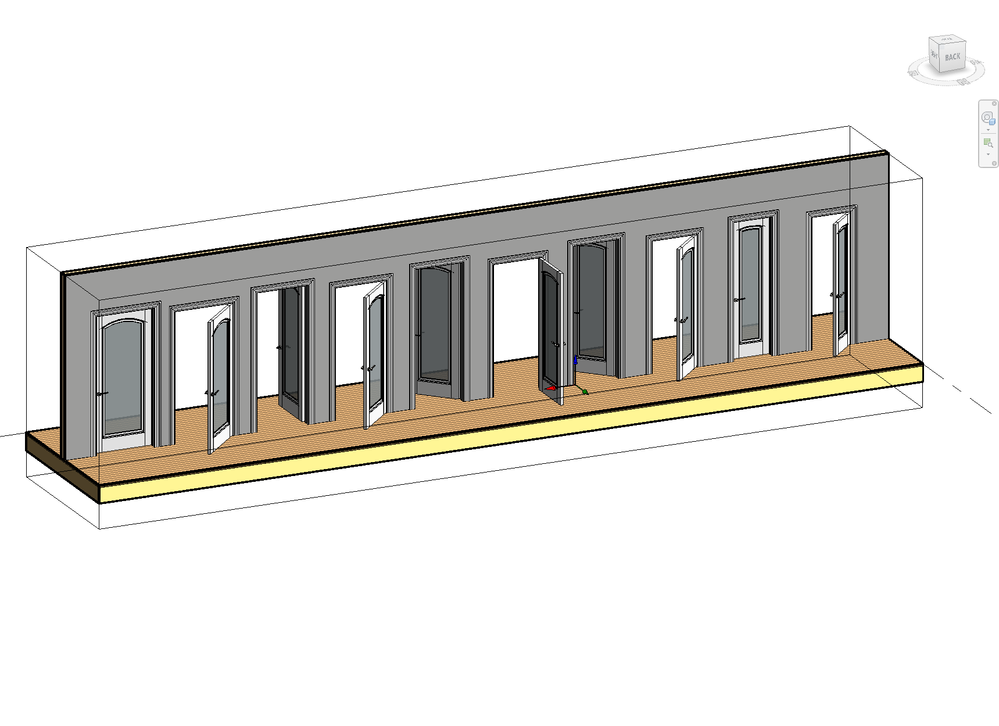

Hi, I'm mot looking for animation, I just want to show it as open and not closed. Is there a way to do it in Revit?
Like this?
zs-17
Hi
Actually like the one in the center which is open at 90 degrees.
ennujozlagam
then you need to edit your door family in the open position. thanks
Those are all the same door family. Door Angle of Opening is an Instance Parameter that can be have any value between 0 degrees and 90 degrees.  The Door Panel is a Work Plane-based Nested Family that is Hosted to a Ref. Line in the Parent Family.  The Ref. Line is rotated about it's axis using a Radial Dimension labeled to an Angle Parameter.  When the Ref. Line moves, the Door Panel goes along for the ride.
