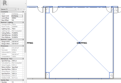

loh_eng_chu
als Antwort auf: ennujozlagam
Hi @ennujozlagam ,
Attached is a sample room space selected (in blue), the boundary is up til its finished wall surface. We wish to extend this space boundary to the red dotted boundary which represents the "center of wall"
This can be done in area 2D, but not in volume 3D currently
Thank you.
