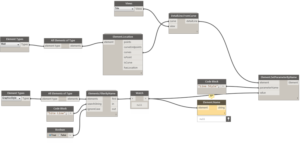

Nachricht 6 von 8
L.Maas
als Antwort auf: mp_thompson
For these kind of tasks I usually use Dynamo. I just add (Detail) lines to the center of the wall.
Screencast Example
Louis
Nachricht 7 von 8
als Antwort auf: L.Maas
Hi @L.Maas would you Be able by any chance to show me how you did that and what you used?
i found one on Dynamo forum but it is somehow not working giving a red error on node and it doesn't work with curve/circles
thanks
Nachricht 8 von 8
L.Maas
als Antwort auf: Anonymous
It was just a concept.
Attached in the zip file the dynamo definition I used. Please note that for some nodes I used the additional clockwork package.
Louis
