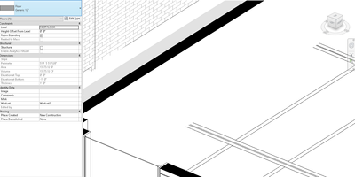

Hi, Intersection line between a basic wall and a generic floor in my 3D view is not visible. Despite checking my visibility settings, Could anyone advise on how to make this intersection line visible?  Thanks,

Thanks for the help, It worked, with Join tool. Now how can we make it for Topography and wall?

- You can use the Cut/Join tool to cut/join the floor from the walls.
- Or adjust the profile of the floor around the walls.

Use Join Geometry (and Switch Join Order if needed).

Worked!

Great, thanks. It worked. Now how can I make the intersection line appear for Topography and wall intersection? Join tool is not selecting topography.

Since you are working in Revit 2023 or earlier you can work with a Building Pad. With (Revit 2024 you can use the Cut tool or make a Mass Void).
Make a type with a Thickness of about 50mm and draw it around your foundation at the bottom Level for example:
