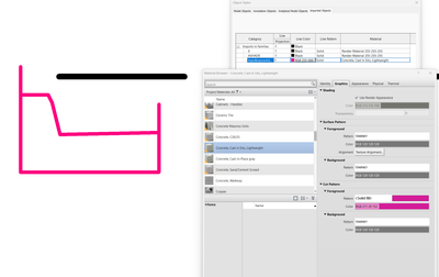

Hello.
I need to import in Revit geometry which I cannot model directly.
The geometry is a closed mesh object.
I import the object into a generic family and then the family into Revit.
From object styles I can control linework appearance which seems to work, and also to apply a material.
The problem is that the material cut pattern does not work on this control level.
As you can see I have no solid fill.
I can control the cut pattern from ''manual override graphics in view"
Why can on the object level, which is view-specific, and not from the project level (object styles)?
Is there a solution to control the appearance of imported objects globally?

Post the Revit Family as well as the file that is imported into it.
