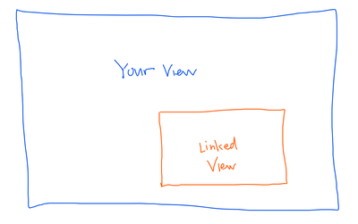

Nachricht 9 von 11
als Antwort auf: naomi2BHGT
@naomi2BHGT wrote:
Do you mean the entire floor view of the new project? If so, then no just for the linked model. If actually using a scope box changes more than just the linked model, then I may just have to use visibility graphics for that view.
So you want something like this?
Nachricht 10 von 11
naomi2BHGT
als Antwort auf: ToanDN
Yes
Nachricht 11 von 11
@naomi2BHGT wrote:
Yes
Then you need to overlay two views with different scope boxes, or different view crop regions on sheet.
