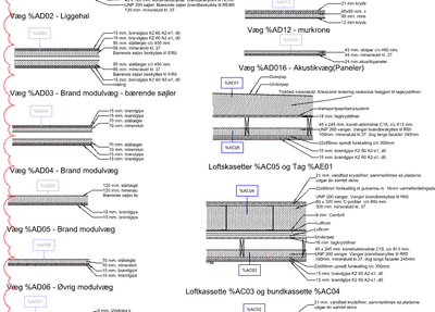

Viewport frame cut annotation in callout
0 ANTWORTEN 0
Nachricht 1 von 1
nlj3RA6A
127 Aufrufe, 0 Antworten
We are experiencing problem when exporting our drawings directly to the CDE - viewport frame cut the text inside of the annotation frame. In some callouts it is visible correct but in some not (see snip under with yellow marks from revit and the other one is final result in pdf. Apparently it first appeared couple of weeks ago but nobody noticed it until now.
