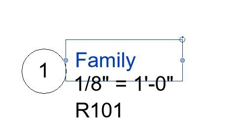

Is there a way to have a view title with larger and smaller text heights? If you edit type and change the text size it changes all the text height in that family. I'm trying to get the section number and family text height to be 3/16" with the scale to be 1/8". Couldn't find anything on here addressing this.revit capture.JPG

If you are editing the type, it will affect all text strings of that type. Instead, try duplicating it, then adjust the text height in that new type. Then you can assign the new type to just the text that you want to change.

Perfect.... Thank You..
