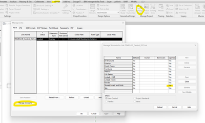

Hi there, I've been thinking how to make levels in the project in the correct way while I have loaded a links with levels already. I checked in my model, levels on the links are clashing the current levels. I tried to hide it, but it can't be. I tried to delete it from the link, but some imported items will be removed. Please, does anyone have any idea how to correct it? Thank you!

Don't delete the Levels from the linked model!!
You can hide them.
1 -You can either turn off the whole workset (They should be on Shared Levels and Grids Workset).
Go tot he Manage tab>Manage links> and then open the Manage worksets form that link and close the Shared Levels and Grids workset.
2- If that doesn't work you can do it in the V/G overrides.  Got to the Revit Links Tab >Select By Host View> Select Custom
Then go to the Annotation Categories , select custom and uncheck levels.
Move the link to where it belongs in relationship to your project and set up Shared Coordinates.  You can hide the Link Levels in your Project via VGOs (Revit Links Tab), and/or you can copy/monitor them (Collaborate Tab).

Dear Juliar123,
Many thanks for your ultimate solution, it really worked and solved my problem. I hope I gonna learn more from you next time.
