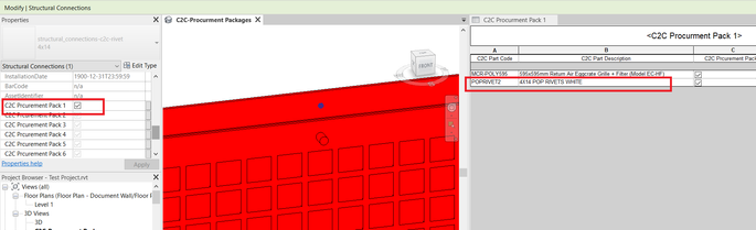

We have a number of shared nested families that we use to create small building structures. These are mainly made up of air terminals,structural connection and generic model. I love the schedule / BOM feature in Revit its so powerful and want to use it release procurement packages to our procurement department.
I have created a number of (Common, Yes/no, general) project parameters (procurement package 1,2,etc) The idea being that we can select items we want in a procurement package and those results will be shown in a filtered schedule. Set up 3d views with different colors to show what is in each procurement package.  /  However The project parameter only associates itself with the main item in the family and not the nested families BUT the 3D view filter associates itself to the whole family.
The screenshots show an example with an Air Grille with structural rivets.
I apply procurement pack 1 to the family
The air grille appears in the procurement package 1 schedule
The rivets have no associated procurement package (so un-procured)
The air grill and rivet are highlighted in the 3D view.
I would like to apply Procurement package 1 to the family:
Air terminal and rivet appear on the schedule
All items are highlighted on the 3D view

See attached, thanks ! So you will see that the air terminal appear in the schedule "procurement package 1" but the pop rivets aren't assigned to any package.  However on 3D view "Procurement packages" the pop rivets are filtered red even though they aren't assigned to procurement package 1.

I select the nested family by pressing tab and check on the C2C Pecurement Pack 1 and it highlight in the schedule. Is this what you want to achieve?

Scrap my previous comment. I see what you want to achieve. The nested will inherit the host family setting. If I checked that off, the nested family will highlight the color. So you may need to make the panel another nested family to make the color shows up properly.
Nachricht 10 von 15
syman2000
als Antwort auf: syman2000
With all the component as nested, you now able to show the component color properly.
