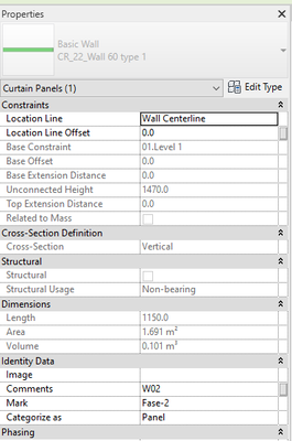

Hello everyone:
I've been trying to use Dynamo to automate the "Mark" field in my curtain panels according to the "Mark" field of their curtain wall host.
In my project I use a wall family as a curtain panel as it's needed to add walls and windows to said walls. Since the positioning of these walls and windows does not match exaclty with the curtain grids,  adding a panel as a window and door is not an option. Therefore I don't use a panel family as "Curtain Panel" for my wall.
This Mark field is used for schedules as I work with prefab panels and I add the name of the host wall to the panel.
My problem is that I don't know how to get Dynamo to identify the walls being used as a Panel in my curtain walls. I have been trying for Dynamo to identify regular walls from walls being used as Panels by using the Parameter "Categorize as" as a difference between the two. I know that the "Categorize as" is an integer with values 0=Panel and 1=Panel. What I want is for the Mark field in my curtain panels automatically updates everytime a change this parameter in the host wall.
This is my Dynamo graph:
And this is my Script:

Alfredo_Medina
I suggest that you post your question in the Dynamo forum, where all the experts are. Here: https://forum.dynamobim.com/
jessica_vazquezKLYLC
I'll ask there, thank you for the suggestion 😊
