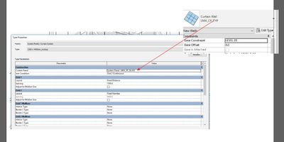

I have created the geometry through Dynamo and then using the massing as a mass face for the curtainwall to be attached to. I have successfully created the curtain wall system but in the curtain wall system the panels cannot be using another curtain wall nested into it.
Also, was wondering if anyone has an insight on what would be the best way of creating a shadow box in the panels family.
Any help will be appreciated.

Nesting a curtain wall type as panels of another curtain wall only works with Curtain Wall, not Curtain System.  I don't now how your system looks like, but you can look into curtain panel pattern base or adaptive family.
