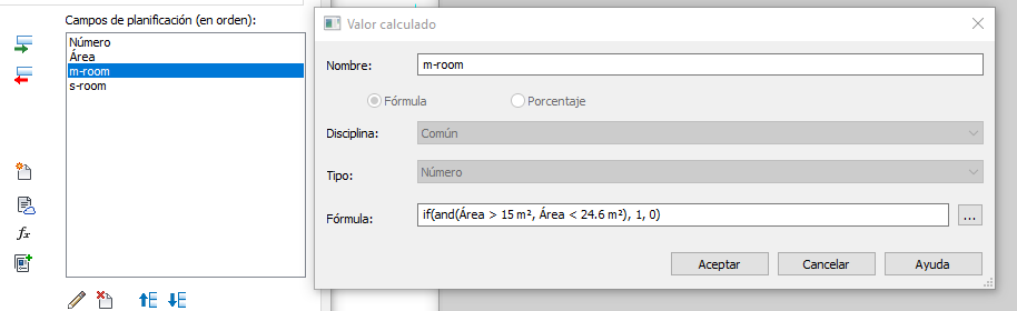

New example of what I want to do that will make things easier to understand.
I want to create a new schedule
I want to create a column that displays level 3,4,5,6
I want to create 2 rows that display SMALL and MEDIUM and these to display a count
SMALL is 0m2 - 13.89m2
MEDIUM is 15m2 - 24.60m2
When I use your forumula, it says - operator not expected <

You can add one calculate text parameter using the formula:
if(Area < 13.90, "SMALL", if(and(Area > 14.99, Area < 24.61), "MEDIUM", " "))
Example:
