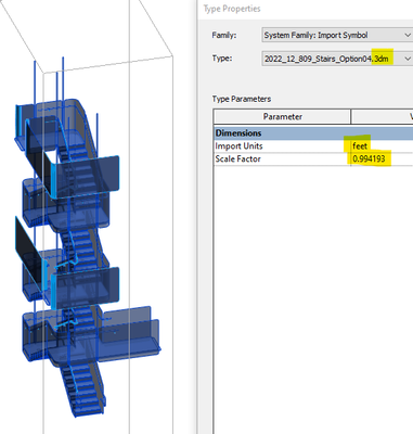

Is it possible to create a 'Custom Unit' in Revit?
We are working with a custom unit in Rhino (shaku, a traditional Japanese measure unit, 1shaku=0.303030303Meters, 1shaku=11.93032689 inches).
We are developing a Rhino.Inside. Revit workflow and have a need of showing shaku as an 'alternate unit' in Revit.
The original Rhino model is always going to be created in shaku but eventually both shaku and imperial units need to be shown on the architectural sheet set.
When we opened the Rhino model in Rhino.Inside.Revit we where prompted to either convert to feet-inches or "continue using shaku".
When we continue to use shaku there is no problem with opening the file however when we open Grashopper we get the following warning "Model Unit Mismatch Warning".

Not familiar with Rhino.Inside.Revit but if you link 3DM in Revit, choose Feet for Import Units, then select the link, Edit Type, and change Scale Factor to 0.994193.
