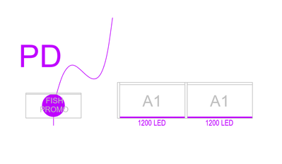

Hi guys, I have this 2 families. Family A is Specialty Equipment and family B is Generic Model. Both have shared Electrical Equipment nested in them but when I use filter to make the Electrical Equipment color purple, the EE family in A is changed to purple but the on in B. why? both EE has the same begin name.
Am I doing it wrongly?

the same EE I load into both A family and B family. Why B family is not follow as A family. :müdes_Gesicht:

So, bumping the "Electrical" Filter up to the top spot on the VGO Filter tab didn't solve your issue?
Nachricht 9 von 9
Mat.Syaf
als Antwort auf: barthbradley
Thanks again bro. Its solved! moved the Electrical filter to the top in the list.
