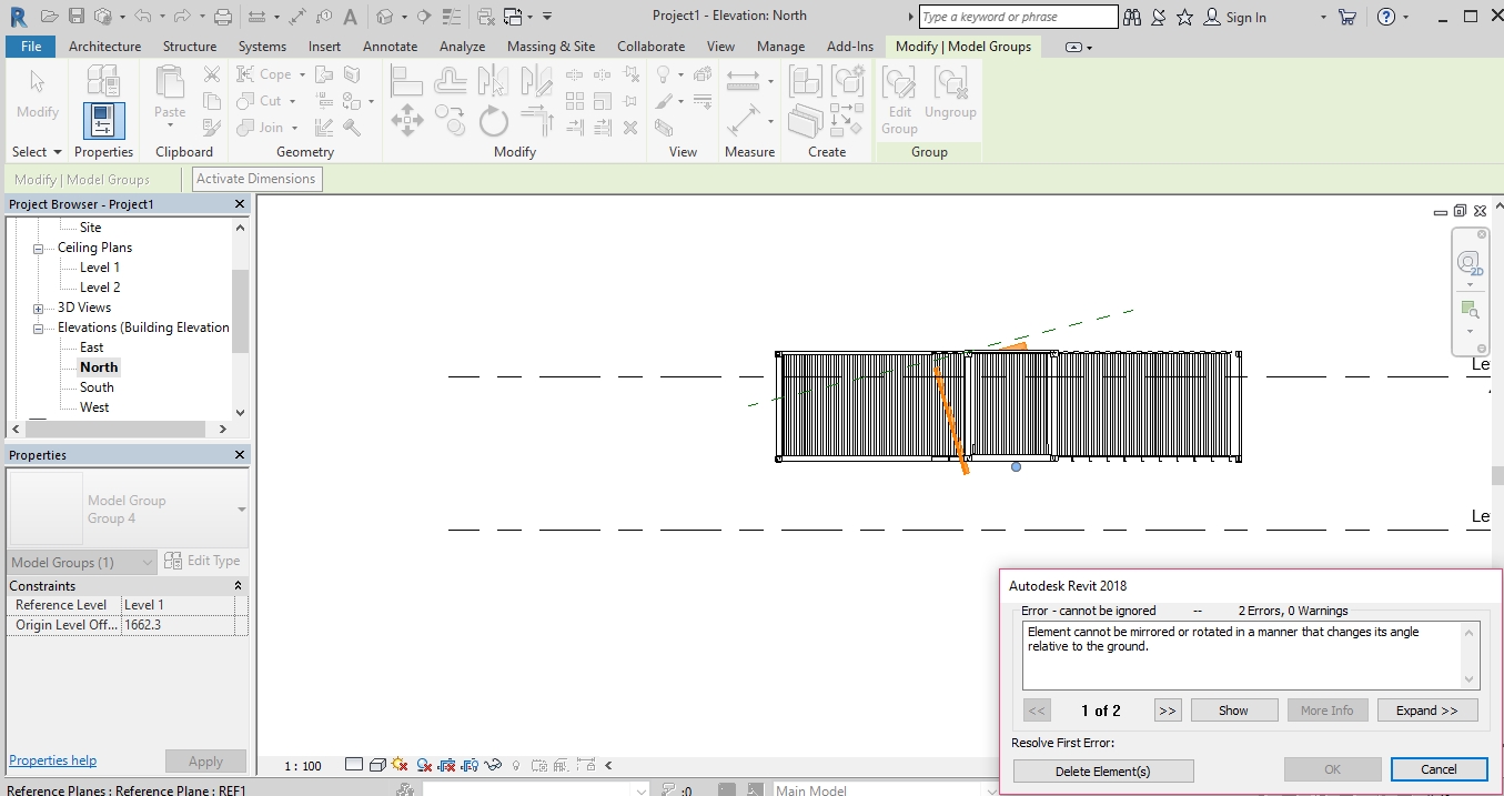

hi
i already know that in order to move item up angular i need to pick new to fer plane, this is not the issue
the problem is that i have bunch of items:
-some shipping containers
-some void families that cut the shipping containers
-some profiles
all this bunch of items should move up angular correctyle
but when i tried to move each item separately i got one big mess not standing correctly as before
please help me
1 ANTWORT 1
Nachricht 2 von 2
Corsten.Au
als Antwort auf: Anonymous
disjoing while rotating, also ungroup elements if not required.. one group is fine, but groups within groups is the main cause of elements getting deleted when moved / rotated etc... best would be to use a Family for this.. but disjoin will help you as of now..disjoing while rotating, also ungroup elements if not required.. one group is fine, but groups within groups is the main cause of elements getting deleted when moved / rotated etc... best would be to use a Family for this.. but disjoin will help you as of now..
