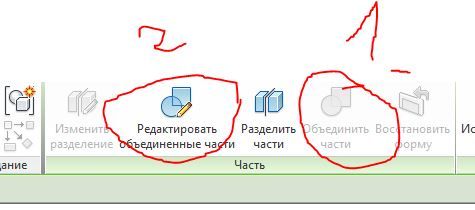

as first step you can combine (1) your parts. line between them will disapear.
when you need to correct the walls you can redact them (2)
it`ll help, but i think using parts was not the best idea )
