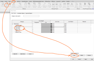

Add subcategories to Detail items families.
