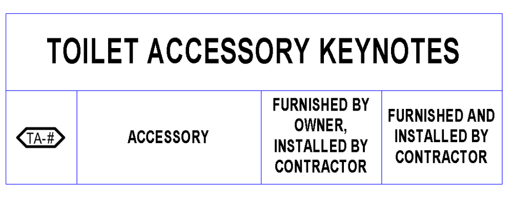

Unsightly break in schedule gridlines when an image is inserted into a cell.
Sahay_R
Is there any way out? My head is spinning now.....schedule is in the attached file.

Hey @Sahay_R !  How's it growing?  Smiley Wink
Just stretch the column a bit wider.
joe_keogh
Hi @Sahay_R
The Capture image you are using in the schedule is masking the Gridline.
You could either do it again and make the capture narrower, or edit it in photoshop or Gimp, and switch the white background to Alpha Channel (Transparent)
