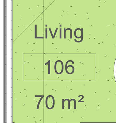

I got a funny problem. Me and my team are working on a Revit model placed on BIM360 server. There is a view placed on a sheet and when I try to place a Room Tag in this view, I got this error:
And the Room Tag I am placing is not visible. I should mention also that this view has many of those Room Tags Family already there and visible!
However, my team members who are working on the same view, with the same View Template, they can place the Room Tag without problems.
Can you direct me why this could be happening?

The rooms you are trying to tag may be in a workset that you closed.

Checked and that is not an issue here.

Any links unloaded?

are you sure that you can select rooms and have room tags visible?

Actually I just found out that these rooms for which I am trying to place Room Tags, are not selected when I select all rooms in the model. However, when I hover over them with Room Tag tools, the Room Tag is being shown.

All the links are loaded!
