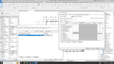

Change Link Annotation Category from BY HOST VIEW to CUSTOM . Then you can use the right-click Hide in View BY CATEGORY method.  Pretty painless.

To do this i use the "APPLY" template method and you can do this quickly for all Views in one go;
Create a New View Template - Turn off Everting other than elements in the RVT Links
In this instance i am going to turn off all the Grids in the Link in all Views I set the View to Custom so i can turn off Annotation elements/categories
Expand all Folders > Click on the Top View in the Project Browser > Hold Down Shift > Click on the Bottom View (this selects all Views) > Right Click > Apply View Template > Select "Grids" View Template you create earlier
All Grids in the Link in All Views are now hidden, and the good thing about this (APPLY) method it doesn't force (ASSIGN) a the View Template in the View (Check Properties Palette).
