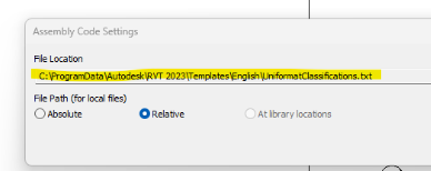

Hello everyone,
I have done my research but I just gave up so I am here.
1. I cannot find the file 'UniformatClassification.txt' on my Revit version (I have the version number 23). Does this need to be purchased on the CSI Uniformat website?
2. Then when I click to browse the file something weird happens to my view. I am able to see the path and somehow the work breakdown structure is shown on the 'Assembly Code' dialog box. Unfortunately I need other codes so I suspect those are missing in the file Revit is looking at. I need the codes:
D5040.10 - Lighting Control
D5040.20 - Branch Wiring for Lighting
D5040.50 - Lighting Fixtures
D5040.90 - Lighting Supplementary Components
And maybe some more
Any help would be appreciate it
Regards,
J

Probably not installed by default. If you happen to have another version of Revit, then look in this path of the other version:
Wit a bit of luck, it should be there. Or use the attached file.

Hi @Simon_Weel
Thanks for the quick response
Unfortunately I do not have another Revit version installed.
Thanks for sharing the file but I think it should be easily accessible on the CSI Uniformat website. For some reason it is not.

Hi again @Simon_Weel
I came across an issue while testing
I need the codes below, but I realized on your file do not exit. On the file you shared the coding jumps from D5030 to D5090. Why is this? Is it because I should look into another Uniformat file?

Good question - I don't know? I checked some other UniformatClassifications.txt files and they are all the same. Maybe there's a more complete version out there?
NB: we don't use this type of classifications in the Netherlands - we use NL/SfB codes.
