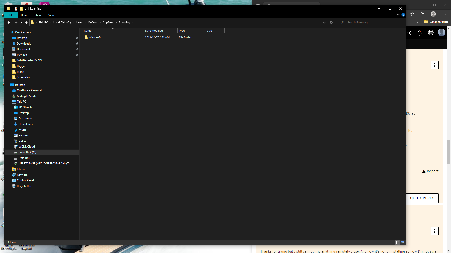

Show a screenshot of what inside C:\users\ folder.
Nachricht 12 von 18
mkERY8J
als Antwort auf: ToanDN
here is a screen shot. I also reinstalled and having the same issues.

Go to View menu and enable viewing of hidden and system files and folders.

als Antwort auf: mkERY8J
Why are you in default folder?  Go back to Users and see a folder with you log in name.

Ok, now I see it. Here is the screen shot for both the Roaming and then also the Local. The Local is the one that I see has the DDGraph. What do I do with that now?

Rename DDgraph to something else and restart Revut.

OMG...that fixed it. I cannot tell you how much I appreciate your patience and walking me through this. I know architecture and how to use Revit, but I do NOT know this technical side so please know how grateful I am. Thank you so much!!!
