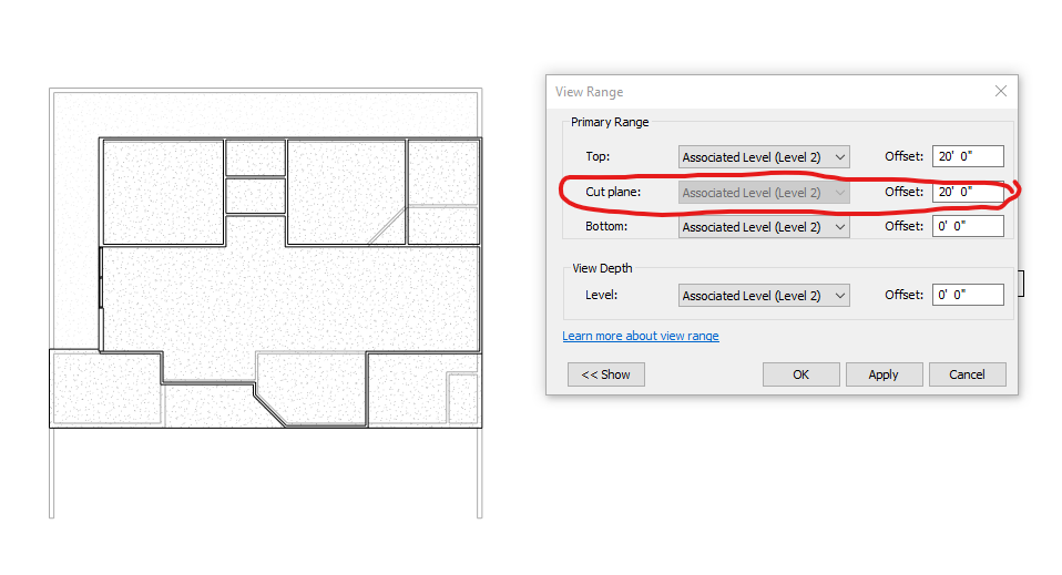

Whenever I select door and window and try to put on the wall in level 2 that time it does not appear on level 2 but when I see in 3D it can be seen. Here below I have attached screenshot of my error.
Thank you.

Can be for a number of reasons:

How did you create Level 2 floor plan view? can you share your file?

1. Doors category is turn off.  VG and check the box.
2. Your view range cut plane is way to high above the door.  Change it to a normal cut height such as 4'-0".
