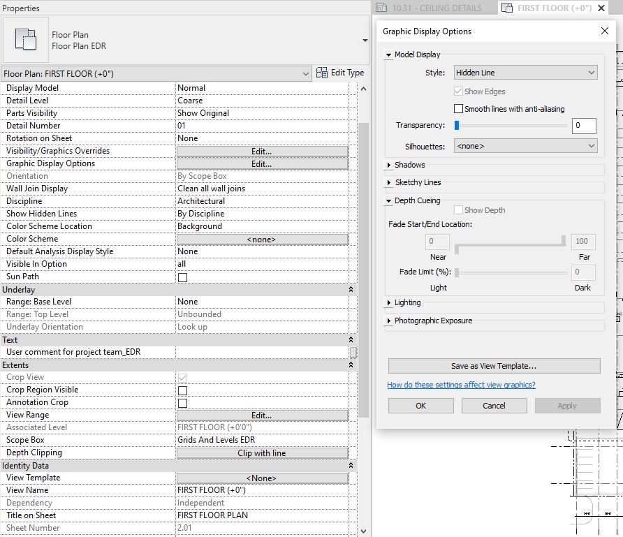

I am unable to turn on the Depth Cueing Graphic Display Option (the Show Depth button is greyed out/locked). I have verified the Discipline is set to Architectural and I have Depth Clipping set to Clip with Line. Of course I also do not have a View Template applied either. Revit 2020.2
Please see attached screenshot and let me know if I am missing anything, thanks!

Depth Cueing is only applicable to Elevations and Sections.

@rauburn You might be able to use view/selection filters to get a similar effect if you must, although it might not be worth the trouble and also can't tell what kind of depth you want to show in these floorplans...

If you want a plan with Depth Cueing use a horizontal section (ie: Place the section >> Rotate it 90 degrees to generate a floor plan (then you have access to Depth Cueing)
  1. You can copy dimensions and most of the tags from the initial Plan view and paste aligned to the Section/Floor Plan except for Room Tags and Color Scheme you will need to re-apply
  2. You will loose benefit of View Range and it's Graphics tricks when it comes to certain family behavior (generic models above cut plane) to compensate for this you would need to adjust the level at which you place the Horizontal section.
