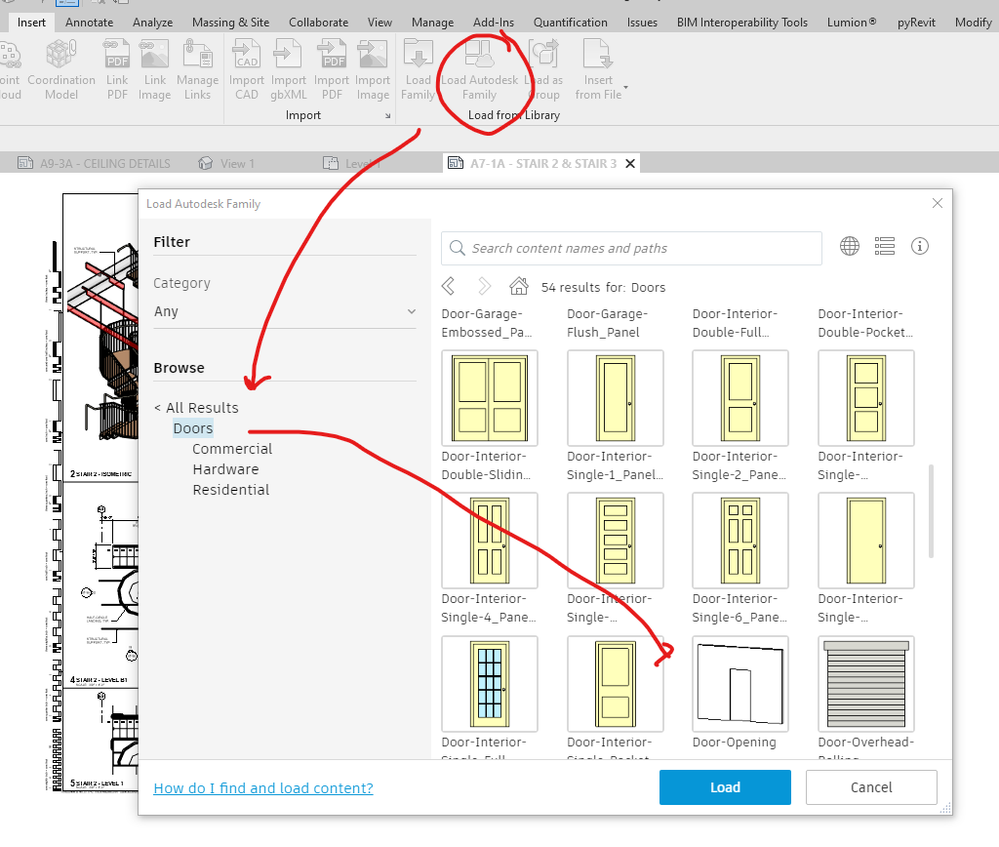

Some categories cannot be loaded using Component: Doors, Windows, Structural members...
Use Insert menu > load family > then find the loaded family in the project browser and drag one of it's types onto your view.
