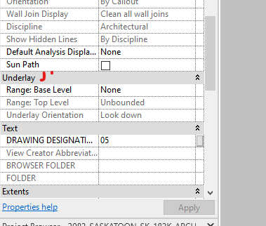

Is the CAD file on the actual RCP view, or is it on the underlay view? You usually can't do much to an underlay view's graphics, check to make sure your underlay is set to "none" to see if this is the case.

This seems to be the issue. What can I do to work around this? I do need the CAD file displayed. I can override the linework with LW, but I'll have to make a new line type to match the exact line style I need and click each individual line, but that seems like a tedious solution.

How I do this is to set your CAD as show by current view only. Then you copy the CAD link to RCP and you will have control settings for RCP. If you rely on underlay, you won't have much control.

Depends, if you want the same CAD on the RCP as you have on the floor plan, select the CAD link and cntl+c, open the RCP and press the paste drop down, select paste aligned to current view. If you want a different CAD for the RCP, just link a new CAD file, and be sure to check the "Current view only" option in the lower left corner of the link window. Either way, set the underlay to "none" so you don't have lines on top of lines with different colours.

How do I check if the CAD is linked as current view only, or how do I change it to it? Do I have to relink the CAD file?
I tried copying the CAD from a plan to the RCP but it does not show up when the underlay is turned off.

I turned off the underlay, but when I try to paste aligned to the current view, nothing shows up.

You have to remove and reinsert the CAD in with Current View Only box ticked.  It is a now view dependent so you can copy paste aligned  from plan to RCP and vice versa.
