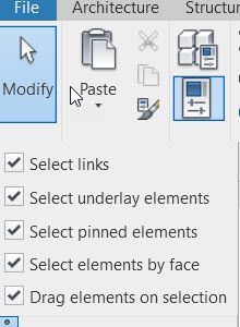

Why am I not able to dimension to some wall cores but I can dimension to others. Tab select does nothing. I can only select core or outside face of the wall.
This is a callout enlarged view.  I can dimension the core with parts turned on but I don't want to use parts.

Is the wall actually a compound-layered wall type with a core?  Are the core edges visible in view?  They wouldn't be if the Detail Level was set to Coarse.
...one more.  Are all these checkboxes checked?
...another one:
Are you using your TAB Key (e.g. TAB-Selecting)?

The issue turned out to be that the common edges were turned off. Once I turned that back on it worked as it should.
